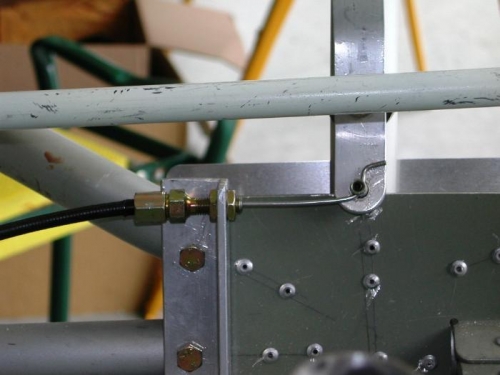

Cut cable notch into forward cable adjuster bracket.
Attach adjuster to cable and mount in bracket. Bend end on control wire into a "z" and fit into cable lock nut.Tighten set screws and secure cable to floor cross brace beneathe forward seat with a nylon cable tie.
Trim control cable at handle end
Cable notch in bracket
