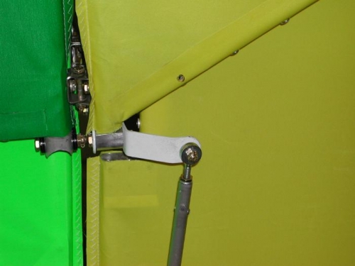

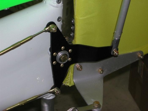

Shorten HC-132A elevator push rod so total length is abour 12-1/2". Drill out as shown in Dwg. 10A and secure threaded insert HS-23 with 1/8" solid rivets.
Secure forked end of push rod to elevator bellcrank with AN3-6 drilled bolt, steel washer, castle nut and cotter pin.
Adjust ball bearing end of elevator push rod to fit to elevator horn and bolt to bellcrank with AN3-7 drilled bolt, steel washer, castle nut and lock washer.
Elevator push rod bellcrank end

Elevator push rod upper end
