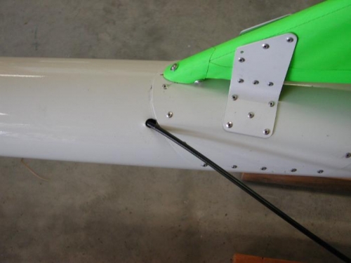

Locate parts and feed trim tab cable from tail through boom through forward bulkhead.

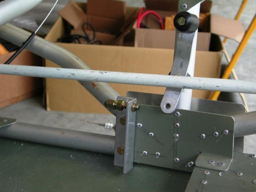

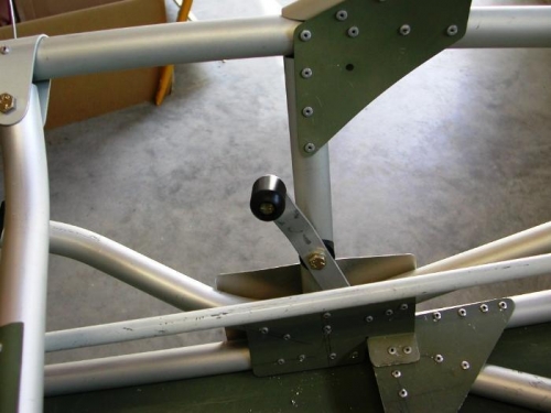

Drill 1/4" hole in left side rail of HF-39A (L). Assemble trim tab handle assembly as shown in "Handle end mounting" Dwg 23A. Secure to side rail with AN4 bolt, steel washers and nylon locknut.
Trim tab control handle
Bottom of trim tab handle
Trim control cable
Trim control cable
