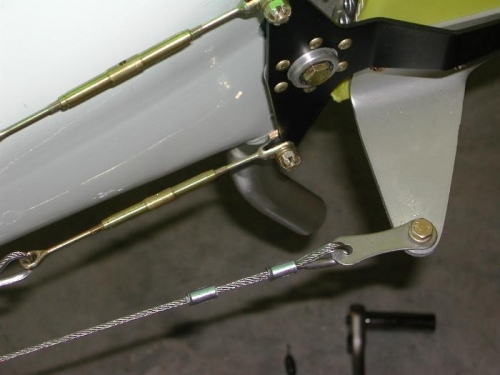

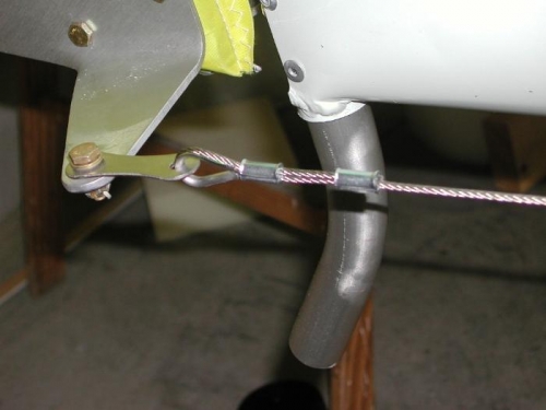

Lock rudder pedals in neutral position and lock rudder itself in neutral position by sandwiching it and vertical stabilizer together with 2 wooden planks secured together with bungee cords.
Swage left rudder cable to tang on left rudder horn. Repeat on right side.

Connected left rudder cable
Connected right rudder cable
