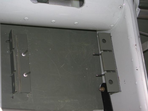

Brief Description:  Battery mounting box
Install Oddyssey PC680 battery mounting box on floor panel of aft seat on right.. Secure to aft of forward bulhead and floor pan using 2" aluminum angle irons drilled and secured with 3/16" HM-16 rivets Cut a piece of 1" aluminum strip 9-3/4" long to be secure to top of battery mounting box to prevent battery movement.
NOTE: manufacturer instructions permit battery to be mounted in any position because it is a sealed unit.
Angle stock for battery mount
