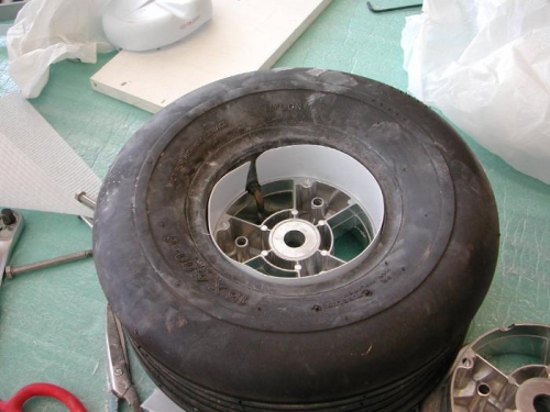

Wheels and brakes
Remove wheels and revise location of brakes so bleeder vaalve is upward. Repack wheel bearings with lithium grease. Unbolt split rims and inset plastic liner to prevent split from pinching inner tube in event of hard landing. Reassemble wheels and pump tires to 25 psi (L&R)

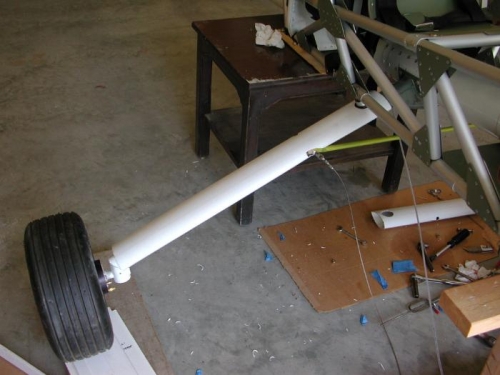

Streamlined Fairings

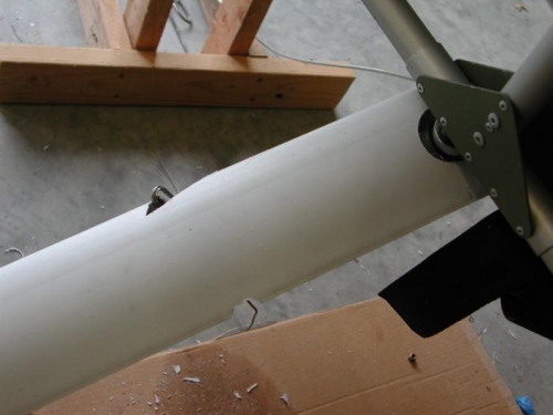

Install streamlined fairings LG-100 (L&R), cutting notches to fit main gear saddle, crossbar and axle assemblies.
Inserting protective liner
Notched out fairing
Notched out fairing
Completed streamilined fairing
