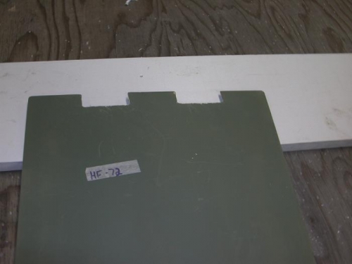

Brief Description:  Preparing seat back for shoulder belts
Test fit shoulder harness for forward seat HF-72, as well as clearance of aft rudder pedals. Notch out an additional 1/4" from top of seat back and trim 3/8" from left forward side of seat back for rudder pedal clearance.
Shoulder harness notches on fwd seat
