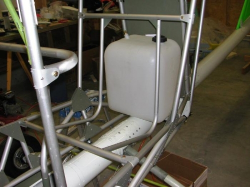

Rear seat side rails
Rivet rear seat side rails HF-73 (L&R) to support tubes HF-74 upper and lower with 1/8" HM-14 rivets. Position main fuel tank aft of side rails.
