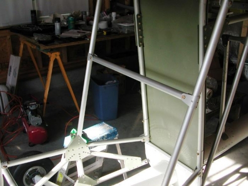

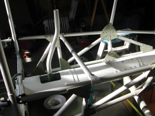

Drill out HB-21 to 1/4" and bolt in upper rear seat cross support tube HF-74 (L&R) with AN4-14A bolts and nylon locknuts.
Using HF-69 rear seat side supports lcate HB-21 bottom rear steat brackets (L&R) on side girder rail HF-63. Secure into place with HM-14 1/8" rivets.
Drill HB-21 (L&R) out to 1/4" and install rear seat bottom support tube HF-74 and secure with AN4-14A bolts and nylon locknuts (L&R).
Lower rear seat support cross tube
Upper rear seat support cross tube
