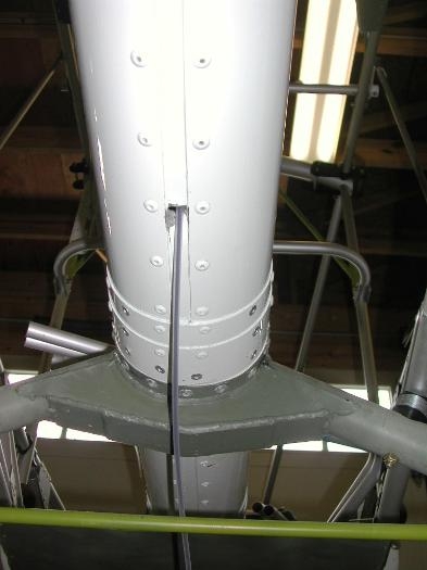

Manual Reference:  Dwg
Brief Description:  Upper elevator control cable
Drill 3/8" hole in bottom of boom midway between aft bulkhead and landing gear sadle. Deburr and using a steel rod form into exit fairlead guide for upper elevator control cable guide which attaches to bottom tang on forward control stick. Snake cable and nylon guide from boom through the hole.
Upper elevator cable exits lower boom
