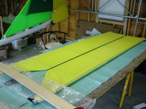

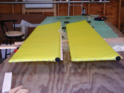

Finish covering L&R flaps by securing fabric with 3 layers of double-sided tape and 1/8" rivets and washers as shown on video.

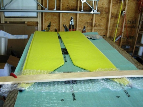

Prepare ailerons for covering using steps for flap preparation on 10/6/08. Hang weights from open end of envelope to stretch fabric overnight.
Ready for securing
Finished flaps
Stretching aileron fabric
