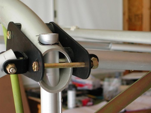

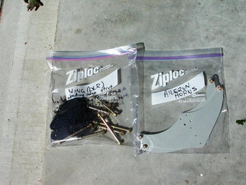

Test assemble leadin and trailing edge strut brackets HB-2A (L&R) with HH-94 (AN4-36A) bolts on leading edge and HH-28 (AN4-25A) on trailing edge, with locknuts and washers. Package parts into hardware assembly bag for later final installation.

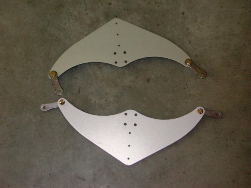

Fabricate aileron horns HC-6 (L&R) using AN3-5 drilled bolts, washers, HM-12 tangs, castle nuts and cotter pins and set aside in package.
Insert wing mounting bolts into fuselage brackets (L&R) as follows: upper leading edge HH-16 (AN4-30A); upper trailing edge HH-4 (AN4-26A); lower strut bracket HH-81 (AN4-17A) and hand tighten with locknuts.

Aileron horns
Aileron horns
Packaged subassemblies
Leading edge wing bolt
