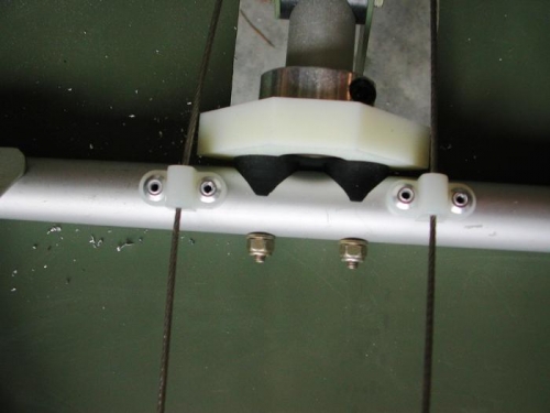

Insert HC-47 3/32 x7 x7 cable into L&R rudder nylon cable guides, route them through HC-25 nylon cable clamps with mounting holes bored out to 3/16" and rivet into place on HC-82 floor ross tube with HH-16L 3/16" long rivets (4 total).

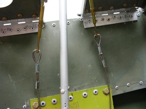

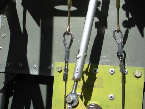

Connect rudder cablles to front rudder pedal turnbuckles HC-48 by swaging cable using HC-47 nico sleeves (2 per cable) and HC-33 cable thimbles.
Rudder cables
Rudder cables
Swaged rudder cables pedal end
Rudder cable guides
Rudder cable guides
