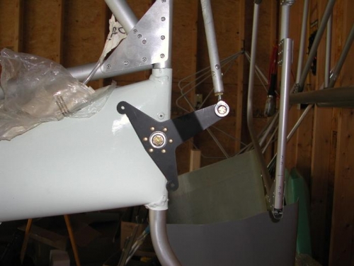

Manual Reference:  Dwgs. 17, 10A
Brief Description:  Elevator bell crank
Assemble HC-2 elevator bell crank with HC-5 standoff, steel washer and AN4-26A colt and locknut hand tight only.
Fit bal bearing end fitting (see Dwg. 10A) to straight elevator push rod HC-132 and secure assembly to bell crank with AN3-6 bolt, castle nut and cotter pin.
Elevator bell crank
Elevator bell crank
