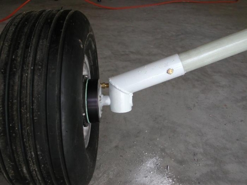

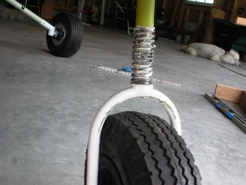

Brief Description:  Mount landing gear
Mount main wheel spindles LG-3 (LR) onto landing gear legs LG-2TP (R&L), make tires paralel fore and aft and then drill out to 3/16" and secure together with HH-32 (AN3-20A) bolts, steel wahers and locknuts.
Remoe paint from nose wheel fork and lubricate liberally with lithium grease and insert into LG-14 nose wheel knuckle. Place 2 LG-76 springs on fork below knuckle and place half spring on top, as shown in Dwg. 18. Align LG-16 steering horn and drill to 3/16". Secure into place with HH-21 (AN3-13A) bolt and locknut.
Attach nose wheel push rod to horn with AN3-6 bolt, nylon washer and castle nut.
Right main gear
Right main gear
Left main gear
Left main gear
Nose wheel in place
Nose wheel in place
