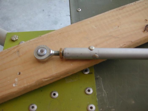

Brief Description:  Nose wheel push rod
Drill nose wheel push rod with 2 1/8" holes at right angles. Using HM-17 solid rivets attach HS-23 ball joint insrt and assemble HS-25 ball joint, HS-2A locknut and HS-26 insert.

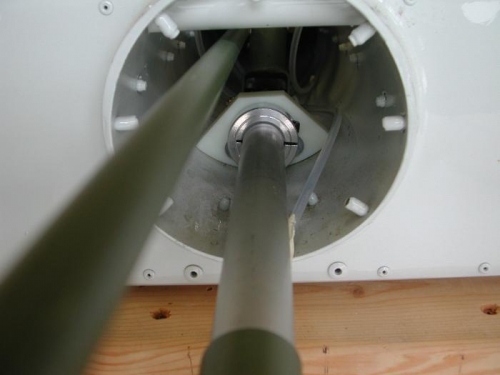

Attach MH-30 tang to bottom of forward control stick assembly with HH-27 (AN4-5) bolt, castle nut and HC-28 cotter pin. See front view detail of control stick on Dwg. 16.
Attach HM-30 tang to bot holding HC-73 to forward control stick using HH-7 (AN4-20A) bolt, steel washer and HH-2 locknut.
Aft control stick inside boom
Fwd control assembly
Nose wheel push rod
Nose wheel push rod
