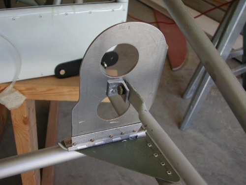

Brief Description:  Rear rudder pedal linkages
Cut 6 holes HM-17 rivets to 3/8" length. Drill 3 1/8" rivet holes and a 3/16" AN# bolt hole into 2 HC-50 angle brackets. See Dwg. 18 detail.
Rivet HC-50 brackets onto underside of each rear rudder pedal. Bolt aft end of each HC-98 connecting rod to angle bracket with HH-13 (AN3-5) bolts, nylon washers, castle nuts and cotter pins. Bolt forward end of connecting rod to botton outside holes in HC-1 forward rudder pedals using same hardware as aft end.
Push rod riveted to rear rudder pedal

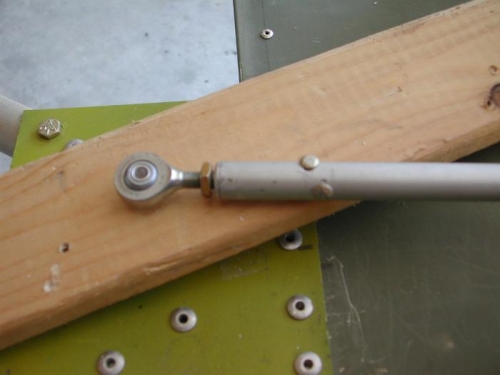

Nose whee steering push rod
