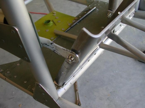

Brief Description:  Reinforcement gussets; nose wheel steering
Spray prime floor panel and gussets HG-18 (4), HG-40 (2), HG-36 (2) and HG-28 (2). Rvet above gussets into place onto HF-39 (L & R), nose girders. See`Dwg. 6
Rivet HF-94 floor cross brace, with nose wheel bell crank mounted on it) into place with HG-18 gussets, all held in place with HM-14 1/8" rivets. See Dwg. 5A.
Bolt LG-17 (L & R) ontoHC-1 forward rudder pedals (L & R) using HH-13 bolts (AN3-5), nylon washers, castle nuts and cotter pins.
Rudder peda linkage, forward
