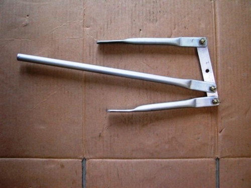

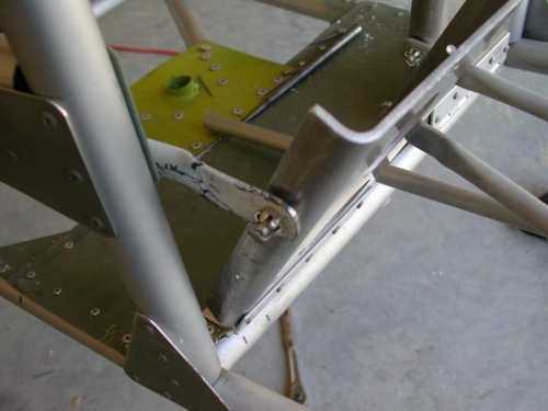

Relocate HC-1 forward rudder and steering pedals to allow for wider spacing and easier access to steering connecting rods. Trial fit nose wheel steering assembly.
Replace HH-30 (AN4-34A) bolts on LG-1 main landing gear saddle with longer (AN4-40A) bolts.
Right forward rudder pedal
Nosewheel steering assembly
Nosewheel steering mechanism
