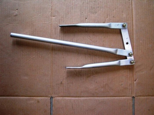

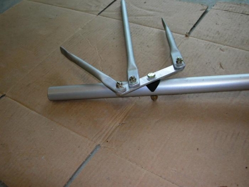

Brief Description:  Steering linkage
Assemblr LG-19 and LG-17 (2) linkage rods to LG-18 steering bell crank with HH-12 (AN3-6) bolts, HM-33 nylon washers, HH-18 castel nuts and HC-28 cotter pins.
Drill out 1/4" hole through center of HF-94 floor cross brace and mount HF-18 bell crank assembly using HH-8 bolt, HM-32 nylon washers, HM-3 nylon sadle and HH-2 locknut.
Drill 3'16" hole at rudder pedal end of each LG-17 connecting rod.
Nose wheel steering bell crank
Crank bolted to cross brace
