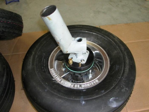

Re-mount landing gear cross tie and 45 deg. bent tangs to forward side of landing gear legs, per email from CGS.
Secure O'Brian brake assemblies (LG-102) to LG-3 spindles with 3 LG-104 stainless steel bolts one each side, and tighten with supplied Allen wrench.

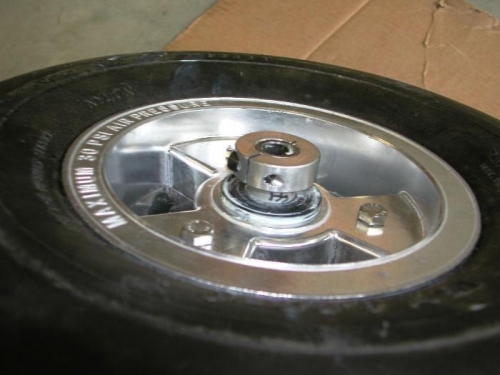

Partially inflate main wheel inner tubes (15 x 6.00-6) (LG-10D) R & L. Fit tire (LG-10C) onto inner half of the wheel rim (LG-78) , sprinkle with talc powder and squeeze in inner tube.
Orient main wheel bearings (LG-10B).
Main gear wheel outside
Main gear wheel mounted with brake
