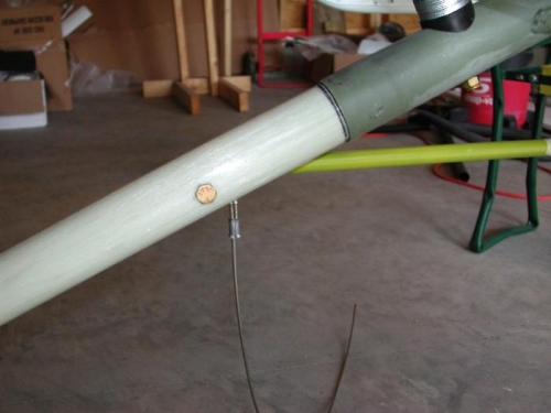

Drill out L side of LG-6R landing gear cross brace and attach to LG-2G (L&R) with HH-7 AN4-20A bolts and locknuts.
Bend steel tangs on ends of LG-70 cables to 45 degree angles and bolt onto LG-2G (L&R) as shown in Dwg. 20.
Orient parts for future assembly of main gear wheels and brakes.
Right side of cross brace with tang
Left side view from aft
