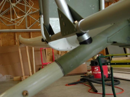

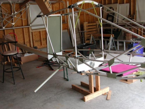

Brief Description:  Install landing gear legs
Apply grease to ends of landing gear legs LG-2 (L&R) and insert into LG-1 saddle. Adjust lengths of insertion so that aircraft is level when resing on the ground and mark locaation with sharpie. Align LG-2 (L&R) so that mounting holes for LG-6R cross brace are horizontal fore and aft.
Using extra long 1/4"inch drill, bore out hole through bottom rail of side girder through LG-1 and LG-2, right and left, and secure with HM-45 and HM-49 saddles, spaced with HP-47 fender washers, and AN4-36A bolts and locknuts.
Order AN4-37A and 40A bolts to replace above 36's as necessary.
Landing gear legs in place
Right leg bolted in
Right leg bolted in
Left leg bolted in
Left leg bolted in
