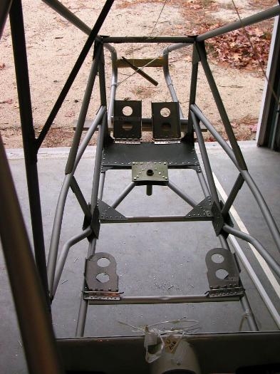

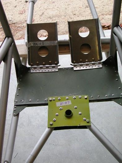

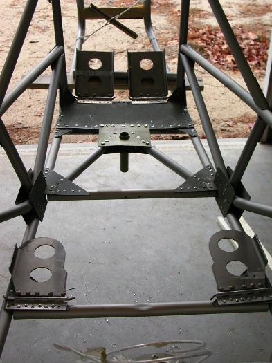

Located and mounted forward rudder pedals HC-1 (L&R) and secured them to HF-38 TP with 8 1/8" rivets each. Repeated for rear rudder pedals HC-90 (L&R) onto HF-102 also with 8 1/8" rivets each.
Reinforced HG-25 gussets (x4) with 2 3/16" rivets each on left and right mid fuselage girders.
Finished riveting forward rudder heel plate with 1/8" rivets
Forward rudder pedals
Rear rudder pedals
Rear rudder pedals
Another view
Another view
