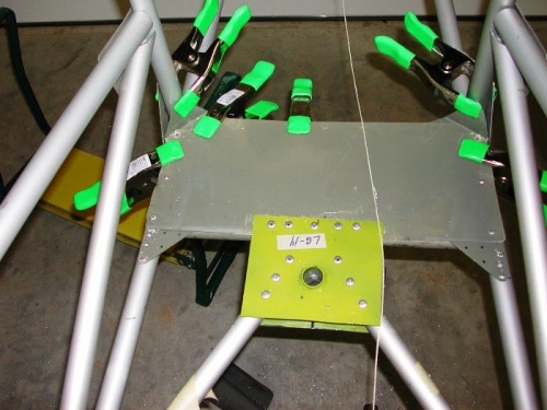

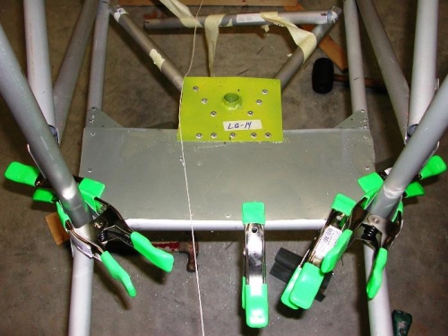

Manual Reference:  Dwgs 5 and 5A
Brief Description:  Rudder pedal heel plate; Nose wheel bracing
Trimmed rudder heel plate HF-37 to fit between HF-21 and HF 38 cross braces and tack riveted it into place with 1/8" rivets.
Straightened flanges on steel nose wheel landing gear knuckle LG-14 and located its forward edge onto cross brace tube HF-21. Note that HF-61 on instructions are actually HF-33 nose wheel diagonals
Rudder heel plate and nose gear knuckle, looking forward
Looking aft
Looking aft
