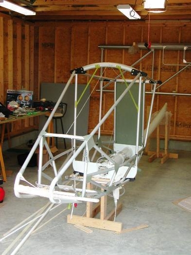

Primed firewall, HM-9 TP, a sheet of 6061-T6 aluminum alloy. Reviewed instructions.
Fitted firewall, cut notches for brackets, drilled firewall and re-installed bolts and locknuts onto HF-7A.
Started riveting firewall into place with HM-14 1/8" rivets.
Inspeection visit from Mike Butts, EAA Tech Counselor, EAA UL62. He says all looks OK.
Forward view of firewall
