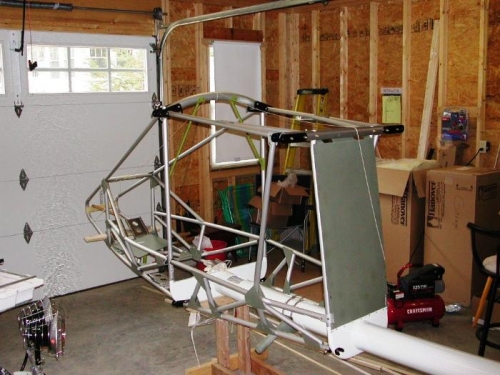

Manual Reference:  Inst. and Drwings
Brief Description:  Rear seat supports
Installed rear seat support tubes HF-24 TP (l & r) between HF-25 TP and top of side rails using HB-21 brackets (2), HH-11 and HH-2 bolts and nuts (2 each), HH-21 and HH-4 bolts and nuts (2 each) and HM-14 1/8" rivets as indicated in Inst 16 and Drawing #4, Parts used:
HF-24 TP (2),
HB-21 (2)
HM-14 rivets (24)
HH-21 bolts AN3-13A (2)
HH-11 bolts AN4-14A (2)
HH-2 locknuts (2)
HH-4 locknuts (2)
HF-24 rear seat support just forward of firewall
