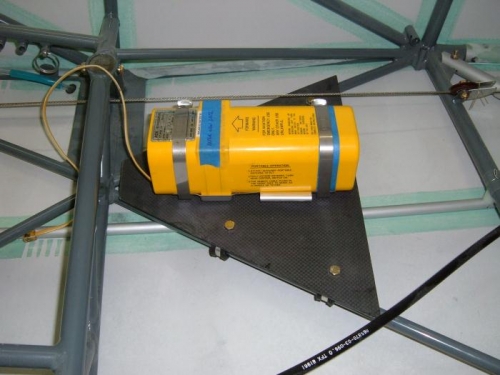

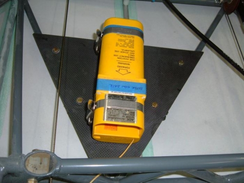

ELT mounted
Trimmed ELT platform to size, drilled holes and attached to steel frame
with adel clamps. ELT is now attached to platform securely.
