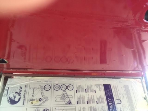

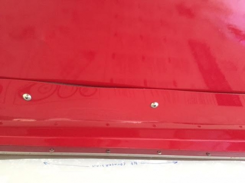

Replaced rivets along center rib on doors with much large ones. Small ones popped where 2 Lexan pieces overlap.
Marked wing root gap seals by pounding each panel onto beheaded screws placed in wing holes.
It worked and drilled through the panels, then screwed them onto the bottom of each wing. They required a bit of bending to correct the sag. This prevents the Lexan at the top of each door from hitting the panel. Both root gap seals permanently installed including foam seals.
