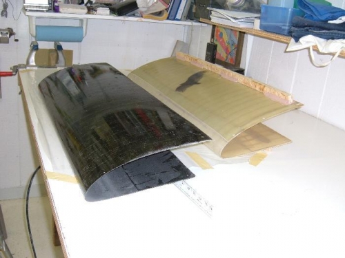

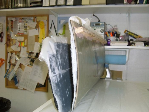

Brief Description:  Molded new skin
Placed 2 bid carbon layup patches on inner skin just outboard of BL50 rib where two drain holes were drilled for drainage during initial cleanout of wing.
Mold of Angier's wing arrived FedEx this afternoon. Placed 2 bid carbon layup inside entire area of wing mold. Placed additional 2 bid carbon from just behind L.E. on upper surface extending around L.E. and to 4 inches aft of L.E.
2 bid in Angier's mold
New outer skin
New outer skin
Initial fit check
Initial fit check
