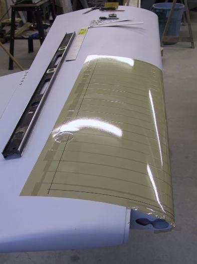

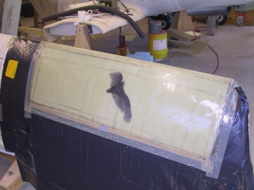

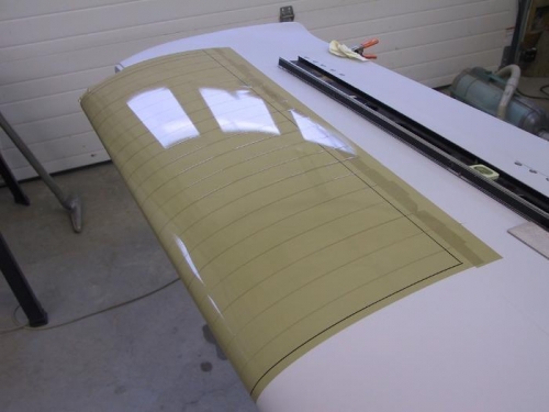

Angier Ames, fellow Lancair 360 builder, masked his wing with plastic tape in preperation of laying up a 5 bid layup onto the areas of his wing that correspond to damages areas of N5ZQ. We will use this layup as a female mold to make new outer skin for N5ZQ.
Layed up 5 bid fiberglass all over plus additional 3 bid in selected areas.
Bondoed wood strips spanwise as stiffeners.
Removed mold from wing and shipped to Virginia.
Angier's wing taped
Angier's wing taped
Angier's wing taped
Angier's wing taped
Glass layup over Angier's wing
