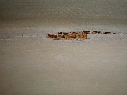

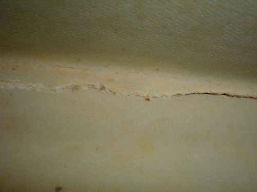

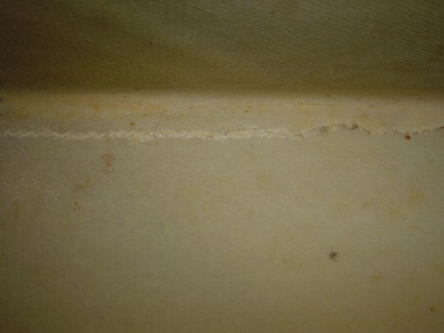

Found damage at interface of forward side of spar web and upper spar cap. Crack is 6 inches long and appears to be only in the 2 bid fiberglass that spans upper cap and forward web face.
Ground away fiberglass at crack.
Found honeycomb core undamaged and attached to skin.
No seperation between spar web and cap even with considerable pressure applied.
Determined damage to be to skin only.
Looking aft at upper spar cap
Skin torn
Skin torn
Skin ground away, core OK.
