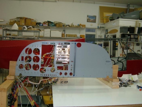

Panel reassembly
Began reassembling instrument panel final time. Installed radio rack with lock-tite on all the screws. Installed sight gauge with hose clamps over 1/2 inch piece of MIL 6000 to lock in place.
Started installing lights and switches.
