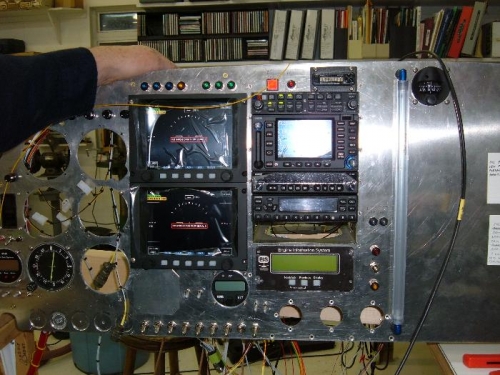

Date:  11-22-2008
Number of Hours:  10.00
Brief Description:  Panel light up
Continued wiring panel. Temp wiring of headphone and mic jacks for test purposes. Wired antenna coax to radios. Lit up panel for the first time...no smoke. Marker beacon OK. Intercom OK, Audio from radios not working properly. GPS OK, Transponder OK, GRT screens OK but require setup programing. Boost pump lights OK, Clock OK.
