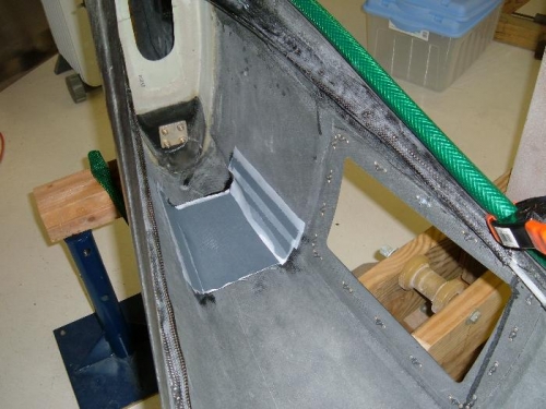

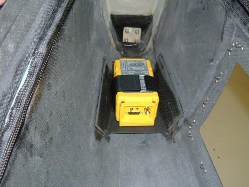

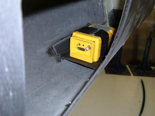

Attached nut plates to 4 bid carbon strips and hysoled these to the bottom of the ELT shelf. Physically installed ELT into aft fuselage.
Sanded and shaped tabs on floor for lower panel.
