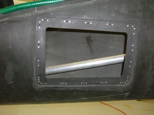

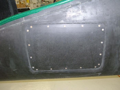

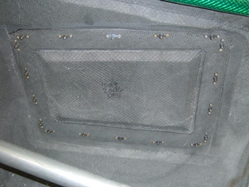

Aft access panel nut plates
Complied with Lancair Service Bulletin SB066-0203
Drilled out and removed #6 nutplates on aft L/H fuselage access panel.
Installed #8 nutplates.
Enlarged door countersink to accept #8 machine screws.
