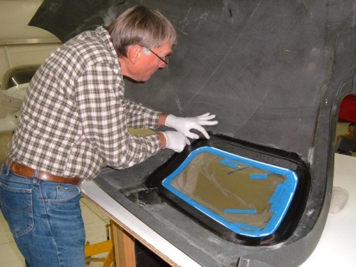

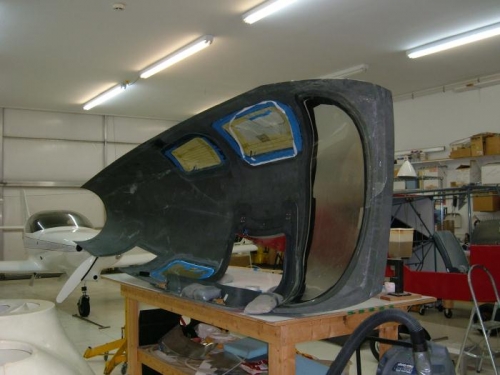

Added 2 bid carbon around all cabin window interriors.
Micro around windshield and all window interriors.

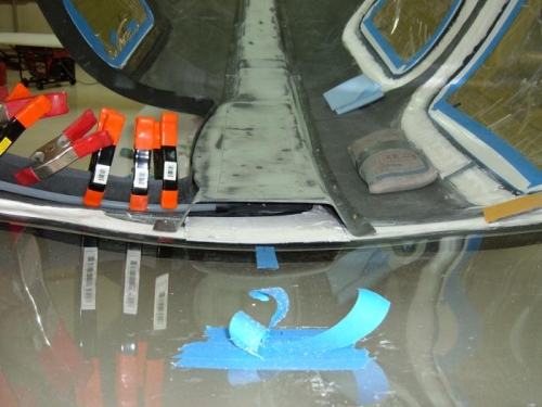

Fitted overhead air duct.
Fabricated and installed electrical conduit running up forward side of door frame to overhead duct.
Removed forward panel on overhead duct. All airflow will be forward.
Fabricated transition from aft end of air duct to 3" tubing for scat tubing.
Bonded air duct to fuselage top.
Micro and bodywork around duct.
Lots and lots of micro and sanding on fuselage top.
