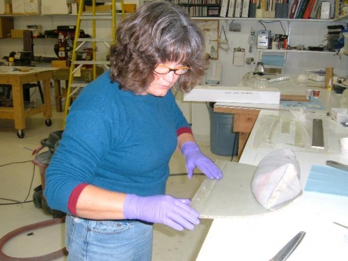

Aft bulkhead & wiring
Sue constructed aft baggage bulkhead. Cored and microed edges. Put 2 bid glass on lower 2 inches each side.
