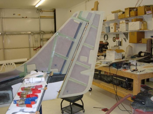

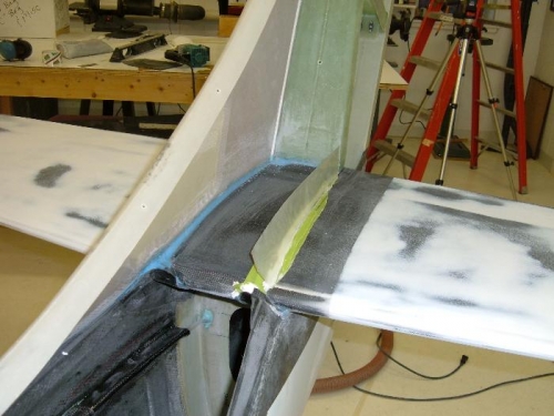

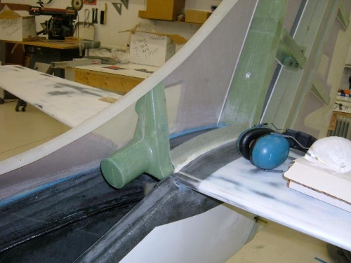

Sanded hysol fillets. Added micro fillet over hysol. Microed aft joint between fus and v stab Preliminary fitting of elevator weldment inspection plate. Prelinimary fitting of rudder. Need 1/16" spacer under upper and lower rudder hinges. Initial fitting of antennas in v stab.
