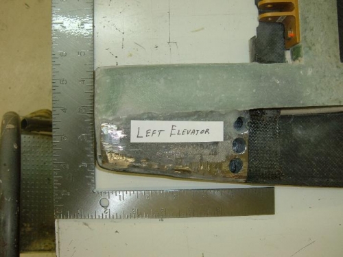

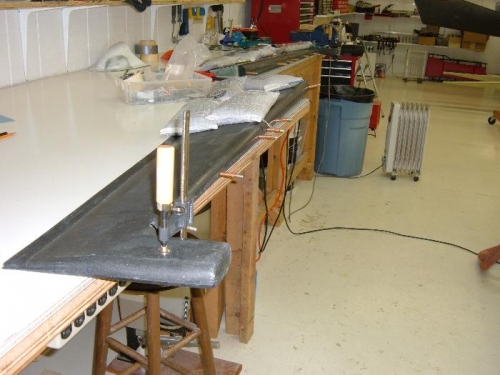

Fitted elevator halves. Lots of trim & fit in the counterweight area. Checked counterweight area with caliper vs corresponding elevator area. Fitted elevator leading edge curve, drilled and clecoed. Cleaned all bonding surfaces with MC.
