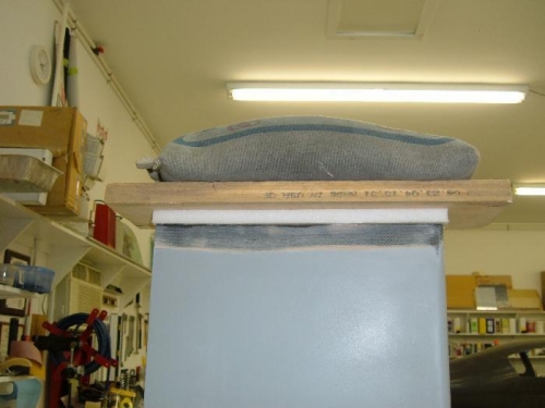

Sanded right flap outboard end. Found LOTS of bondo added by factory. Microed 1/2 inch foam to outboard end of flap as basis for increasing span to decrease flap/aileron gap.
