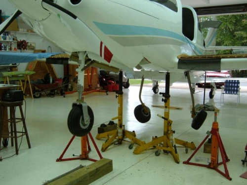

Lots of work checking off details on the punch list. Last check of all control systems continuity. Filmed gear retraction/extension check at the request of the DAR.

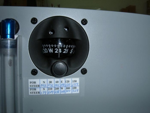

Swung compass and made compass correction card.

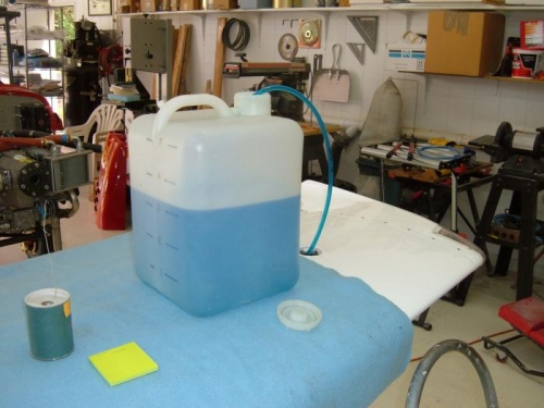

Filled each wing tank seperately, each holds 55 gallons. Calibrated wing fuel quantity indicator.

Calibrating fuel qty indication
Filming retract test
CCC
CCC
