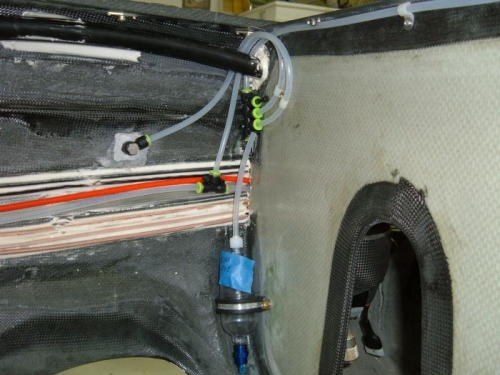

Bob Pastusek came over today and helped a great deal. Bob Installed the bosses that I had made earlier into the wheel well interrior for static ports, installed two drain bottles and plumbed the left and right static ports together and teed into the static line running to the ADHARS units behind the wheel well. Thanks Bob!!
I bored holes in the gear box for ADF antenna cable, another for StrikeFinder antenna, and another for wires for the gear and gear door micro switches.
Fabricated and installed a bracket for a micro switch to detect flap extension for the AOA system.
