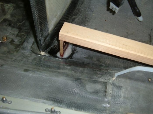

Fabricated MLG door brackets from phenolic. Bonded brackets onto fus inside bottom with epoxy/flox.

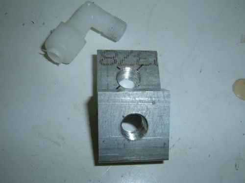

Cut two 1" squares from 3/8" aluminium stock. Drilled and tapped for 1/8 NPT. These will be for static ports.
