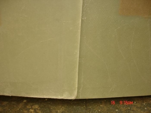

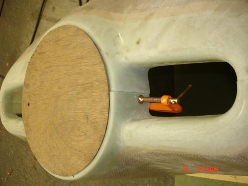

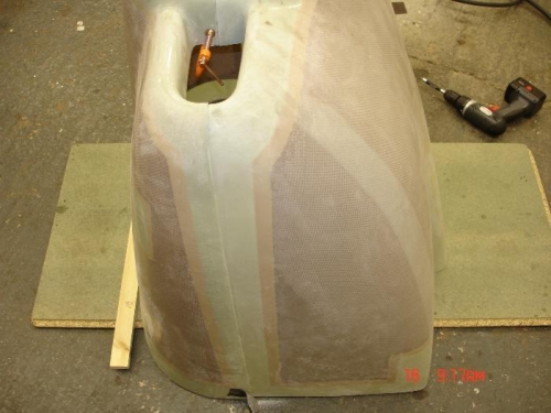

Because the cowl halves are slightly over size and require trimming, I measured the maximum depth of the firewall and fixed the back of the cowl to a board at that measurement allowing the two halves to overlap. Clamping and triming the front to get the correct diameter behind the spiner was then straight forward.
Back of the cowls held at about the correct spacing
Allowing the sides to overlap at the rear
Trim the front to get the correct diameter
