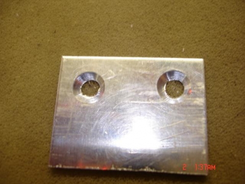

The maual has you dimple the side skin for the screw head that holds the tube clamp at the rudder cable exit, problem is you need to accomodate the dimple at the rear otherwise the skin will distort when tightening the screw.I countersunk some scrap alli to fit between the skin and the clamp, and got a much better result

Made a couple of spacers
Fit them between skin and clamp
