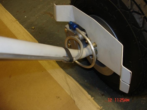

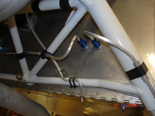

Fitted the brake pipes, I find that if you wrap a bit of self amalgamating tape around the powder coated tubing it stops the tiewraps from slipping.
I found it simpler to run the brake pipes down the front of the leggs
Poly tube acts as standoff
