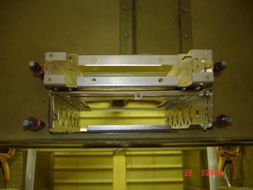

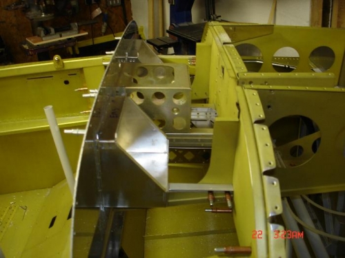

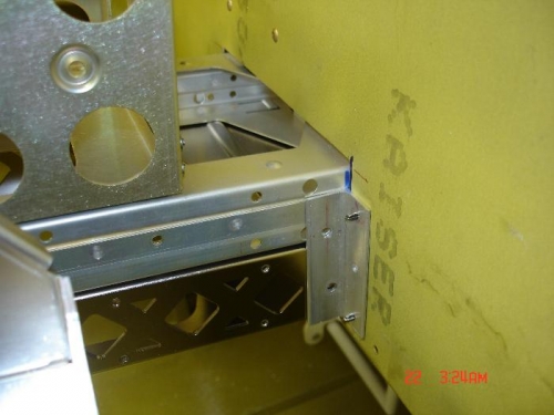

Date:  10-23-2006
Manual Reference:  P4
Brief Description:  Panel work
I fitted two support angles under the dynon trays, my plan is to screw the bottom of the trays to them which will triangulate the load through the dynon trays which are riveted to the panel, it may look flimsy but believe me this has turned out strong and firm.
Dynon tray support angles
Rear tray support angles
