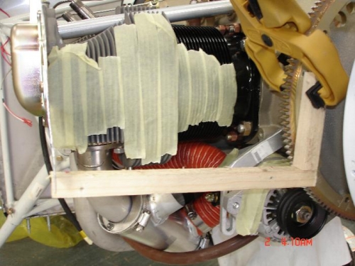

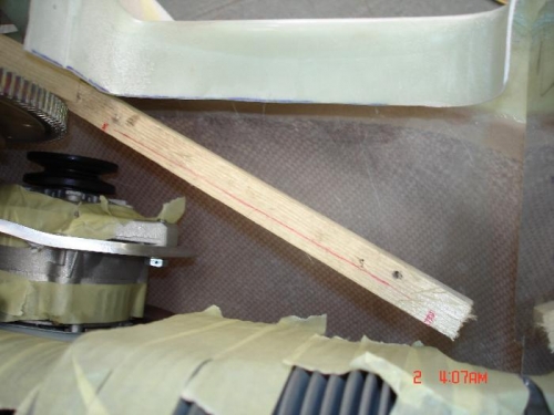

Baffles/inlet floors
I wanted to come up with a better way to position the inlet floors and airbox without taking the bottom cowl on and of repeatedly, a couple of battens clamped to the ring gear did the trick
