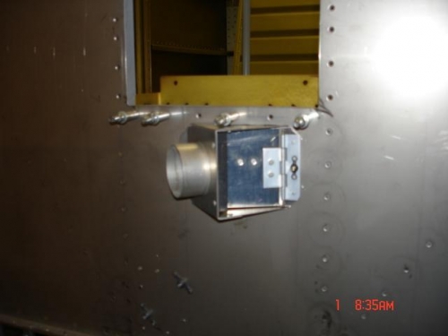

Hot air valve box
I drilled the hole in the Firewall using a 2" hole cutter at very low rpm, and sealed it with PU adhesive sealer
Hot air valve fitted to firewall
